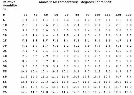

So you're saying that the temperarture doesn't matter as long as I get a RH which gives around 8 mc. Right ?
So today I'm at 80F 60% RH = 11.7% mc
So the idea is that I have to heat the cupboard till the temp and RH coincides with 8%mc.
My gut feeling would be that the MC would stay the same - I guess I must be wrong ?

Temperature has less to do with mc than the humidity,
the chart shows that. Relative humidity is what you
need to watch. The storage cabinet needs to vent too
help drive off moisture. You need to raise the temp.
for that to happen. There is room to play with on the
moisture content of wood, it depends on where the instrument will live.
On the coast RH is higher 10% is better, in a dry desert region Id feel safer with 6%.
Hope this helps.
